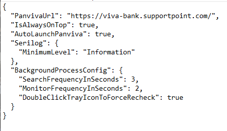

How do I change/customize the search and monitoring frequency?
You can update the configuration settings as follows:
Ensure PBE is not running. If PBE is currently running, close it from the system tray.
Go to the following relative folder path, replacing
<username>
with your actual username:C:\Users\<username>\AppData\Roaming\© Upland Software, Inc. All Rights Reserved\Panviva Browser Extender\1.0.4.
Open the Appsettings.json file using Notepad or another text editor. (see screenshot below)
Update the following frequency settings in the Notepad:
Enter a new value in seconds for
SearchFrequencyInSeconds
MonitorFrequencyInSeconds
Save the changes and close Notepad.
Launch PBE to apply the new configuration settings.
What is the impact of adjusting the search parameter value?
Adjusting the search frequency settings will cause PBE to take more time to automatically locate the Panviva browser window and apply the Always on Top feature in case the connection is lost.
Example: If the search interval is set to 6 seconds, PBE will wait up to 6 seconds to reconnect to the Panviva browser window.
