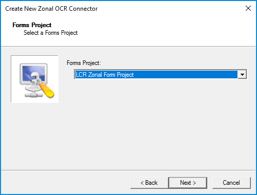

On the Forms Project wizard page, select a form project on the Forms Project list.
See the Forms Project wizard page below.

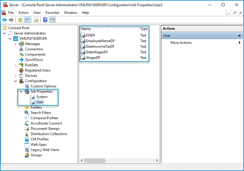

Go to the Configuration node on the Server Administrator tree and click the arrow to expand, if necessary.
Go to the Job Properties node and click the arrow to expand.
Right-click User and select New > Job Property. The Job Property dialog box appears.
Type a job property name for the form project data field in the Name box and click OK.
Repeat Steps 8 – 9 until all required job properties are created.
Ensure the required user job properties appear on the list.
See User Job Properties example below.

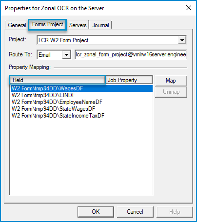

Select the Zonal OCR Connector on the list. The Properties for Zonal OCR on the Server dialog box appears.
Click the Forms Project tab.
See Properties for Zonal OCR on the Server dialog box below.
