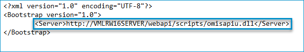

Editing the Bootstrap.xml file
Using Notepad, you must edit the Device Client > Configuration > Bootstrap.xml file.
To edit the Bootstrap.xml file
Open File Explorer.
Go to C:\Program Files (x86)\Upland AccuRoute\DeviceClient\Configuration.
Find the Bootstrap.xml file.
Right-click the file and open with Notepad.
See the Bootstrap.xml file below.
Find the <Server> tag and change http to https.
Select File > Save.
Note: Edit the permissions in the Bootstrap.xml File Properties if you cannot save the file.
