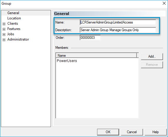

The Administrator at Medical Company A creates a power user group with limited server administrator secure access. This group will not be able to view documents, manage secure access, or modify view document settings while using the Server Administrator. Members of the PowerUsers Group must logon before accessing the Server Administrator.
The Administrator creates a PowerUsers group.
See the Configuration > Group Properties dialog box example below.

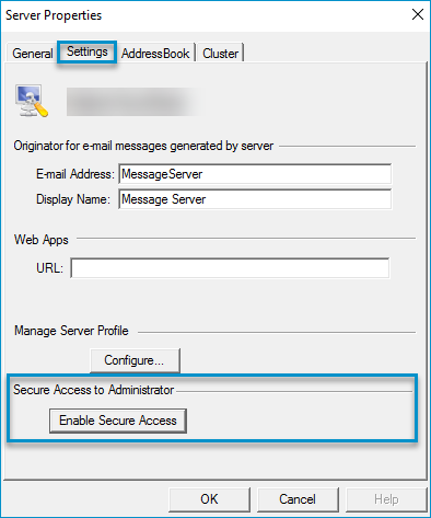

The Administrator enables secure access.
See the Server Properties > Settings dialog box with Enable Secure Access example below.

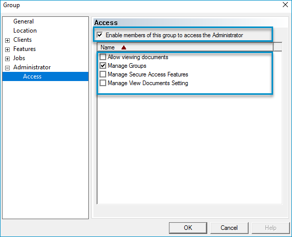

The Administrator applies only the Manage Group permission to the PowerUsers group.
See the Configuration > Group Properties > Administrator Access dialog box with Manage Groups permission example below.
