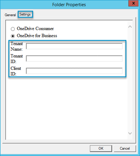

  6. Select the Settings tab.
  7. Ensure OneDrive for Business is selected.
See the Folder Properties > Settings dialog box example below.
  1. Specify the Tenant (OneDrive) name.
  2. Specify the Tenant and Client ID.
  3. Click OK.

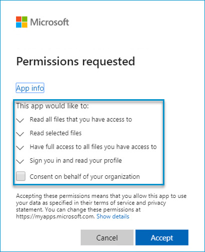

  5. Sign in to OneDrive. The Microsoft Permissions requested dialog box appears.
See the Microsoft Permissions requested dialog box example below.
  1. Click Accept. The OneDrive folder with red x icon changes to a blue check mark on the WebApps > Preferences > Authorizations page.
