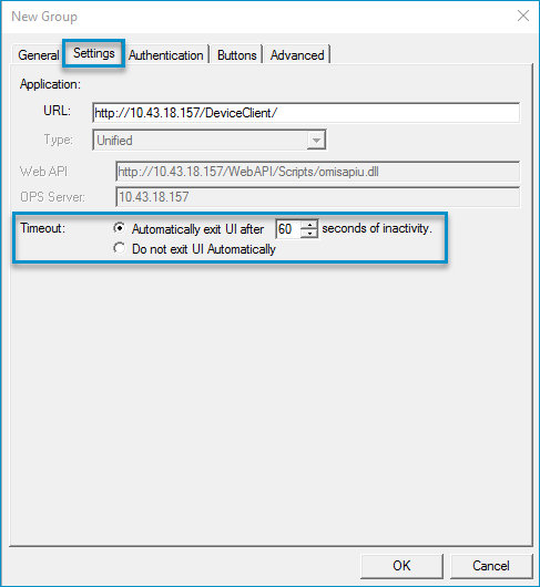

  4. Click the Settings tab.
  5. In the Timeout section, set or verify what the Automatically exit UI after inactivity value is. The default is 60 seconds.
  6. Update the value, if necessary.
  7. Click OK.
See an example of the Device Group Properties > Settings dialog box with the Timeout section below.

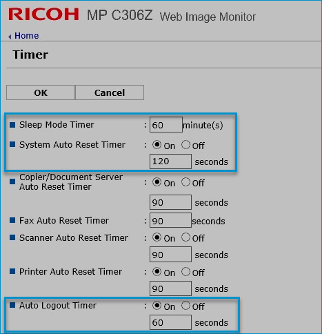

From the Web Image Monitor
  1. In the Web Image Monitor, select Device Management.
  2. Select Configuration.
  3. Below Device Settings, select Timer.
  4. Set or verify that the following device timers are greater than the Automatically exit UI after inactivity timeout value.
    • Sleep Mode Timer
    • System Auto Reset Timer
    • Auto Logout Timer
  1. Click OK.
See an example of the Web Image Monitor with the Timer section below.
