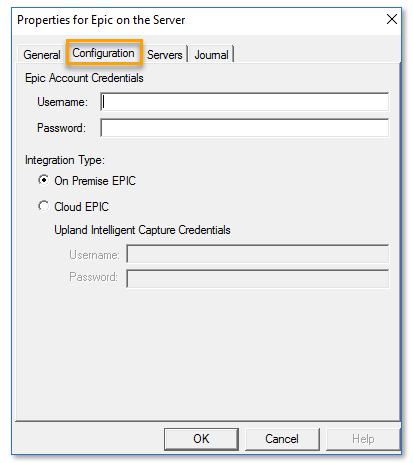

To set up the Epic connector
Right-click the Epic connector in the Connectors details pane. The Properties shortcut menu appears.
Select Properties. The Properties dialog box appears.
Select Configuration.
See the Epic Connector Properties dialog box example below.
Specify your Epic account credentials in the Username and Password boxes.
Note: Both Cloud and On-prem configurations require the Epic account credentials.
Select one of the following Integration types.
On Premise EPIC
Cloud EPIC
Specify the Upland Intelligent Capture credentials in the Username and Password boxes if Cloud EPIC is selected.
Select OK.
