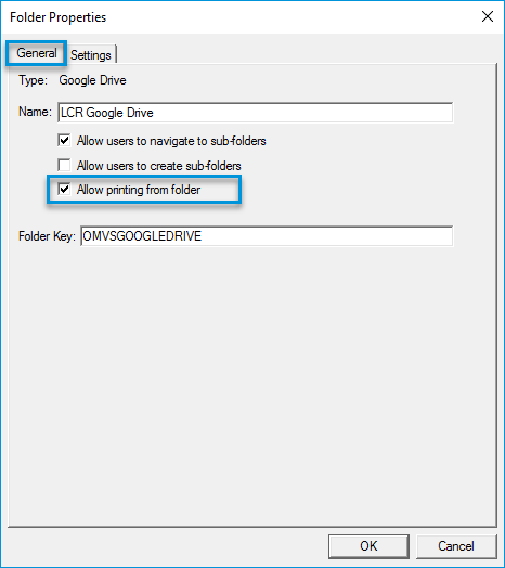

To apply the Allow printing from folder property
  1. Start the Server Administrator, if necessary.
  2. Select Folders on the Server Administrator tree. The folders appear in the Folders details pane.
  3. Select the appropriate folder.
  4. Select the General > Allow printing from folder check box.
See the Folder Properties dialog box example below.
  1. Click OK.

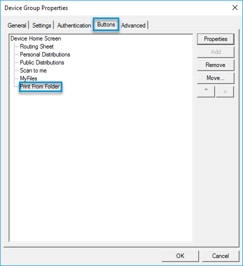

To apply the Print From Folder button to the device
  2. Select Devices on the Server Administrator tree and use the arrow to expand, if necessary. The devices appear in the Devices details pane.
  3. Select the appropriate device. The Device Group Properties dialog box appears.
  4. Select the Buttons tab. The Device Home Screen button list appears.
  5. Click Add. The Add Button dialog box appears.
  6. Select Print From Folder on the Type drop-down list.
  7. Use the default name or type a new name in the Name box.
  8. Click OK on the Add Button dialog box.
  9. Ensure the Print From Folder label appears on the Device Home Screen button list.
See the Device Group Properties example below.
  1. Select Print From Folder or use the Properties button. The Button Properties dialog box appears.
  2. Select the Options tab.
  3. Select Display the following folders and then choose all or specific folder check boxes.
  4. Click OK on the Button Properties dialog box.
  5. Click OK on the Device Group Properties dialog box.
Note: The devices in the Device Group must be reinstalled after adding the Print from folder button to the selected device(s).
