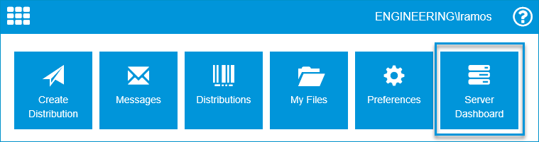

Accessing Server Dashboard
You can access the Server Dashboard by opening the WebApps application.
To access the Server Dashboard
  1. Open your browser.
  2. Type or paste your specific WebApps URL in the browser’s address bar.
  3. Press Enter. The WebApps application appears.
  4. Select the Server Dashboard tile. The Server Dashboard appears.
See WebApps > Server Dashboard tile example below.
