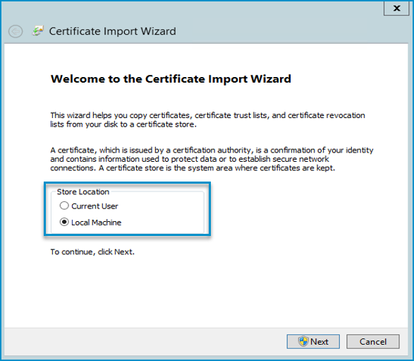

  1. Right-click the certificate's filename; for example, *.crt. The File Explorer shortcut menu appears.
  2. Select Install Certificate. The Certificate Import Wizard appears.
  3. Select Local Machine and click Next.
