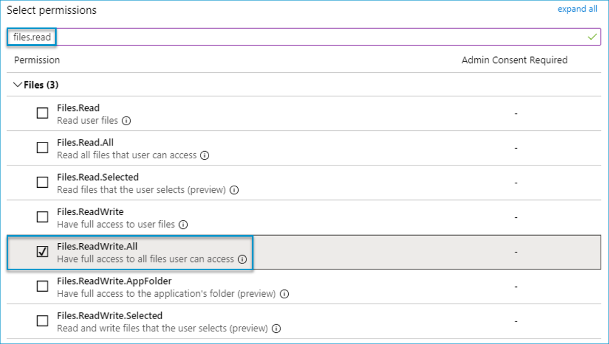

  11. Type files.read in the Select permissions box.
  12. Select Files.ReadWrite.All on the Select permissions > Files list.
See the Select permissions page example below.
  1. Select Add Permissions.

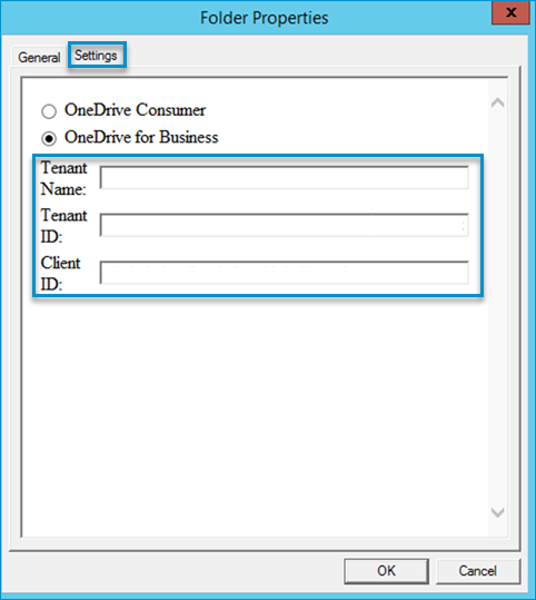

  5. Specify the General parameters.
  6. Select the Settings tab.
  7. Ensure OneDrive for Business is selected.
See the Folder Properties > Settings dialog box example below.
  1. Specify the Tenant (Primary Domain) name.
Note: The Tenant name is the Primary Domain name, for example, primarydomain.onmicrosoft.com found on the Azure Active Directory > Overview page. You will need to sign in. It shows your specific primary domain name. Only use the information that appears before the first period in onmicrosoft.com.
  1. Specify the Tenant and Client ID.
  2. Click OK.

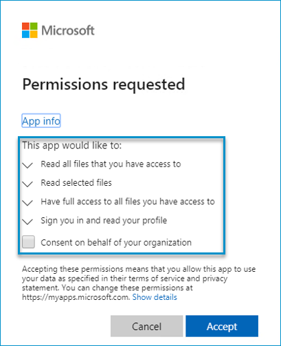

  5. Sign in to OneDrive. The Microsoft Permissions requested dialog box appears.
See the Microsoft Permissions requested dialog box example below.
  1. Click Accept. The OneDrive folder with red x icon changes to a blue check mark on the WebApps > Preferences > Authorizations page.
