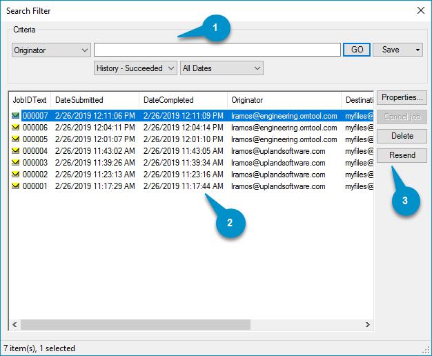

Search Filters at a Glance
Search Filters Legend
1. Criteria area
Use the Criteria area to:
  • Criteria drop-down list - Select Search Filter criteria.
  • Search bar - View and select search filters.
  • Go - Run search filters.
  • Save, Save As, Columns - Name and save search filters and/or customize the search result columns.
2. Search Results area
View search results list.
3. Properties, Cancel job, Delete, and Resend buttons
Use the buttons to:
