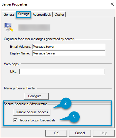

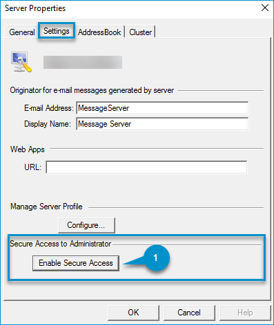

Server Administrator Secure Access at a Glance
                                                             Server Properties Dialog Box Legend  |
                                                             Description  |
                                                         1. Enable Secure Access button  |
                                                         Use to enable group members Server Administrator MMC access and select groups.  |
                                                         2. Disable Secure Access button  |
                                                         Use to remove secure access to the Server Administrator MMC. Only the secure access flag is removed from the group configurations. Secure access groups are not removed or deleted. Note: You will not be able to see the Administrator > Access property in the Group properties dialog box when this property is disabled.  |
                                                         3. Require Logon Credentials  |
                                                         Use to enforce logging on before accessing the Server Administrator tree. Notes:
