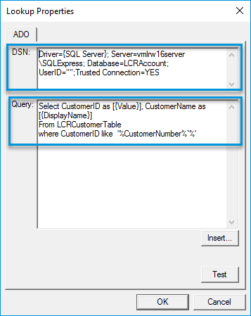

Select a Validation type on the Validation drop-down list, click Configure and specify your Validation requirements (optional).
Select Database (ADO) on the Lookup drop-down list.
Click Configure.
Specify your DSN and Query parameters in the DSN and Query boxes.
See the Lookup Properties > DSN and Query parameters example below.
Click OK on the Lookup Properties dialog box.

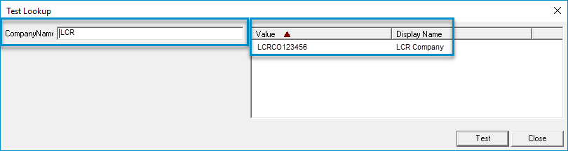

To test the Database lookup
Click the Test button on the Lookup Properties dialog box where you specified your DSN and Query parameters. The Test Lookup dialog box appears.
Specify your search criteria in the box.
Click Test.
Click Close when you are done.
Note: A message appears if the server cannot perform the test. The message shows any exceptions that occurred during the test.
