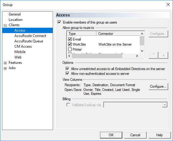

  1. Go to Groups on the Server Administrator tree.
  2. Create or select the appropriate group for WorkSite access. The Group dialog box appears.
Expand to view more information.
  1. Expand Clients, if necessary.
  2. Click Access. The Access pane appears.
  3. Select Enable members of this group as users, if necessary.
  4. On the Allow group to route to area, select WorkSite in the Type column.
  5. Go to the Options area and select the appropriate options for your configuration.
    • Allow unrestricted access to all Embedded Directives on the server
    • Allow non-authenticated access to the server
  1. Click OK.

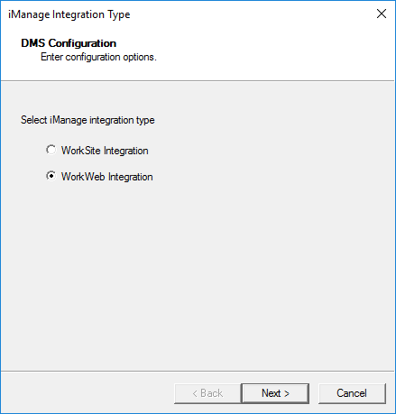

  3. Select Configure DMS > WorkSite. The DMS Configuration wizard > iManage Integration Type step appears.
  4. Select WorkWeb Integration as the Integration type.

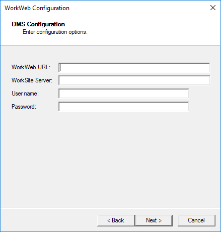

  2. Type the following information in the appropriate boxes.
    • WorkWeb URL
    • WorkSite Server
    • User name
    • Password

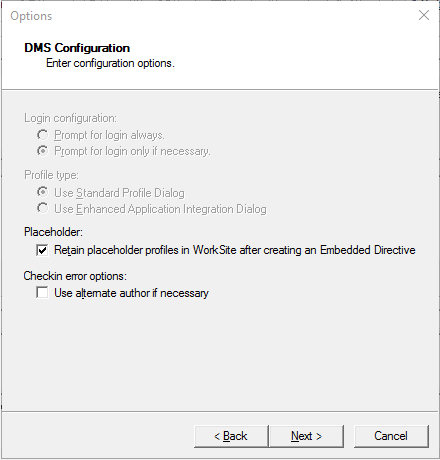

  1.  Click Next. The Options wizard step appears.
  1. Select the appropriate Placeholder and Check in error options for your configuration.

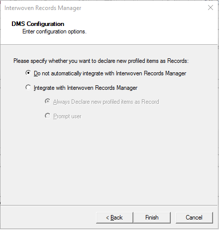

  1.  Click Next. The Interwoven Records Manager wizard step appears.
  2. Select the appropriate option to specify whether you want to declare new profiled items as records.
  1.  Click Finish.
