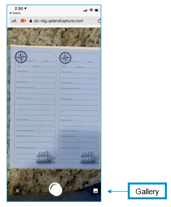

Capturing a document
Upland AccuRoute Mobile Capture’s automatic scanning functionality can detect the edges of your document and automatically capture it without you using any buttons on your device. When you open Mobile Capture for the first time, it requires access to the camera on your device. Click Allow. It will then begin searching for a document to capture. Mobile Capture is currently only supported in portrait orientation.
Using the camera on your device, hover over the document until it is recognized. The document is automatically captured.
You can tap Gallery to select an existing image from your device.
See Capturing a document example below.

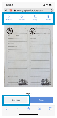

Editing a document
You can edit a captured document by selecting any of the following options.
Retake - Recapture the document.
Rotate - Rotate the document at 90 degree intervals.
Crop - Crop the document.
Delete - Delete the document from Mobile Capture.
Add Page - Add additional pages to the existing document.
Tap Done when you are finished.
See Editing a document example below.

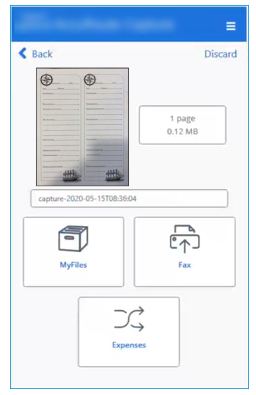

Selecting a destination
After a document has been captured and edited, it can be submitted to MyFiles, Fax, and Public Distributions known as Embedded Directives. In addition, the number of pages and document size are shown on the screen. A default name with the date and time of your document capture appears. You can give it a different name in the box provided.
Note: The Name box cannot be left blank.
Tap one of the following workflows.
MyFiles to send the document to your personal MyFiles.
Fax to send the document as a fax.
Public Distribution (known as Embedded Directive) to send the document to a company-specific distribution.
See Selecting a destination Expenses example below.

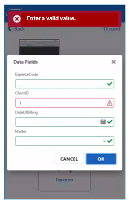

Capturing additional information
Some workflows may require capturing, validating or looking up additional information associated with your documents. Tap OK when you are done.
See examples below.
Metadata and field length validation example |
