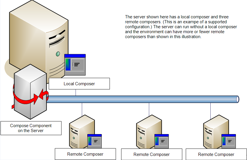

Composers are licensed based on a thread count. By default, the server includes two threads and will activate up to two composers (limited only by the total thread count). Additional composers can be added to the server or they can be installed and run on a remote system.
The Compose component (Composer) is a system that performs message conversion tasks for the server. A server supports multiple composers, all managed by the Compose component on the server. A remote system that hosts a composer is called a Remote Composer.
When you install a server, the Compose component is installed as part of the Component Package and a Composer is created locally. As Composers are added, the Compose component workload is distributed automatically. Workload distribution can be manipulated by modifying the capabilities of each Composer. By default, a General Composer composes all types of messages, all enabled file types and final formats, and all template types, but each Composer can be modified to accept only certain types of jobs. This filtering enables a Composer to become specialized for certain types of conversions. It is also possible to enforce policies that would cause messages with certain types of files or templates to fail. See About Compose Component for more information.
