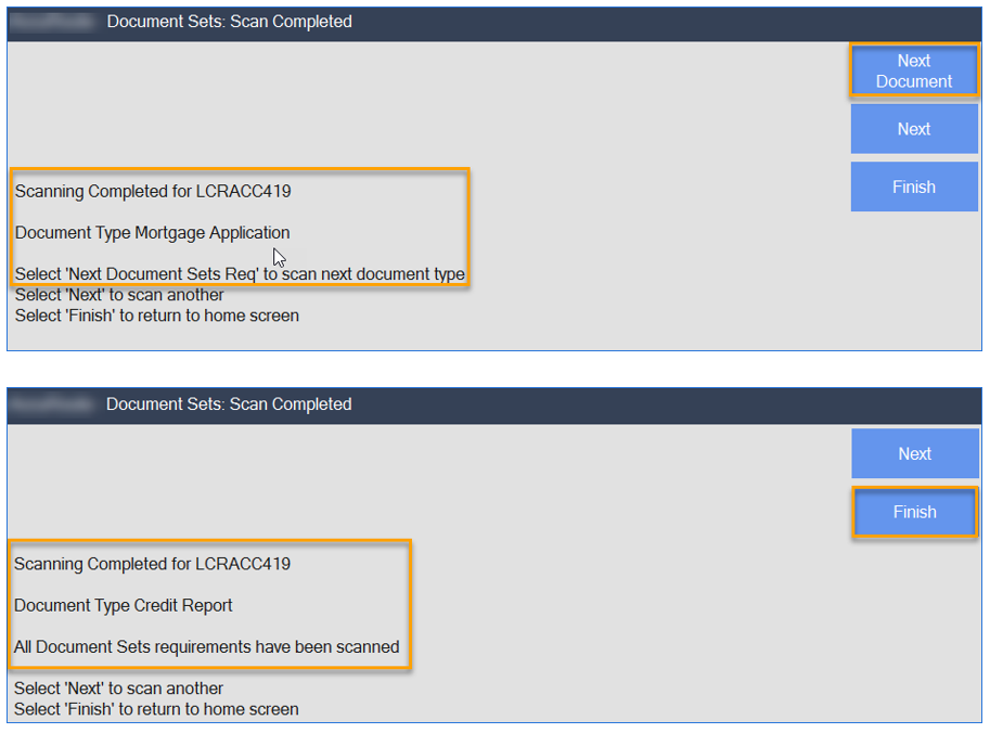

Complete the steps on the device’s display.
Select Start.
Select Next Document if there are more forms to scan.
Repeat Steps 3 through 7 until you are done.
Select Finish.
See Document Sets Scan Reservation example below.
Form field and form types - Account ID, Mortgage Application, and Credit Report
Next Document Set Requirement - Credit Report
