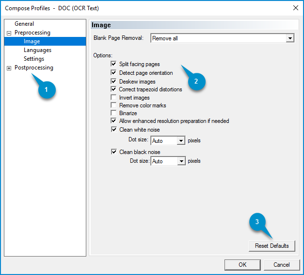

Pre and Postprocessing Settings at a Glance
There are two types of settings that can be applied to a document which include:
Compose Profile Dialog Box Legend |
Description |
1. Navigation and Selection pane |
Use the Plus or Minus (+) (-) icons to expand or collapse the Pre and Postprocessing categories. Use to navigate and select different categories. |
2. Preprocessing and Postprocessing pane |
View and select Pre and Postprocessing settings. |
3. Reset Defaults button |
Use the Reset Defaults button to reset specific default settings, if necessary. |
