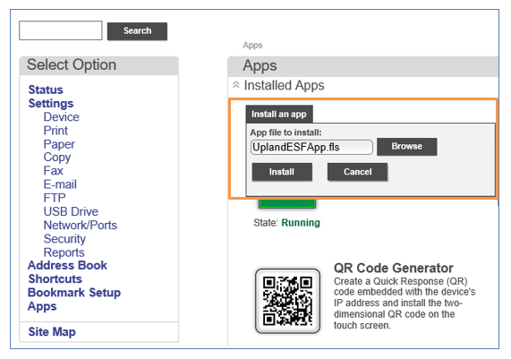

To install the Upland AccuRoute ESF Application JAR file
Open the device’s EWS (Embedded Web Server) by entering the device’s IP address in your browser’s address bar.
Select Apps on the Select Option pane.
Select Install an App.
Go to ..\Program Files (x86)\Upland AccuRoute\DeviceClient\Installation\Lexmark.
Select UplandESFApp.fls.
Select Install.
See the example below.
Select OK.
Continue with Configuring Upland AccuRoute ESF Application JAR file.
