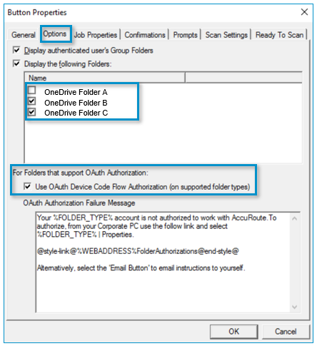

- Ensure the appropriate Display options and folders are selected.
- Below the For Folders that support OAuth Authorization heading, select the Use OAuth Device Code Flow Authorization check box.
- Click OK.
See the Button Properties > Options dialog box example below.

Users will get the following OAuth Authorization Failure message at the device if the Use OAuth Device Code Flow Authorization option is not enabled during setup. Users must follow the instructions indicated in the message. See example below.
Example: OAuth Authorization Failure message
