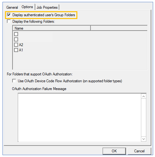

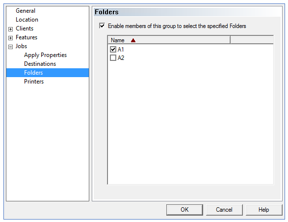

Example: Allow printing from folder at the Group level
The Administrator at company A creates 2 folders. The A1 folder is set to allow printing from the folder. The A2 folder is not. By using Configuration > Groups, the Administrator enables members of a group to only select the A1 folder. In this example, the Print from folder button is configured by only selecting the Display authenticated user's group folders option. The Display the following folders option is not selected. The A1 folder is the only folder that is displayed at the device and allows printing.
| Group > Folders Properties | Device Group > Button Properties |

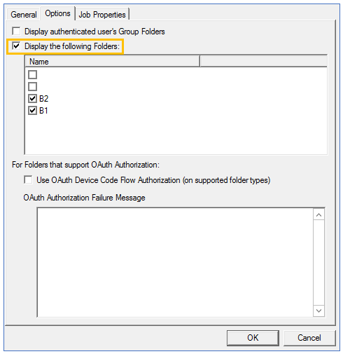

Example: Allow printing from folder at the Button level
The Administrator at company B creates 2 folders. The B1 folder is set to allow printing from the folder. The B2 folder is not. By using Configuration > Groups, the Administrator enables members of a group to only select the B1 folder. In this example, the Print from folder button is configured by selecting the Display the following folders option. Both B1 and B2 folders are selected and will be displayed at the device and allow printing. The button level options override the Group level options in this scenario.

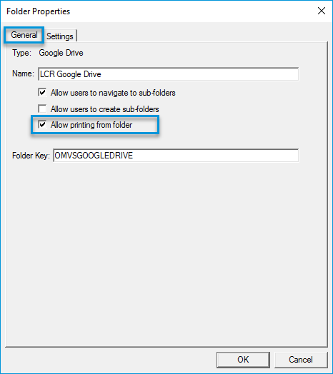

You can apply the Allow printing from folder property when creating or modifying folders used for printing.
To apply the Allow printing from folder property
- Start the Server Administrator, if necessary.
- Select Folders on the Server Administrator tree. The folders appear in the Folders details pane.
- Select the appropriate folder.
- Select the General > Allow printing from folder check box.
See the Folder Properties dialog box example below.
- Click OK.

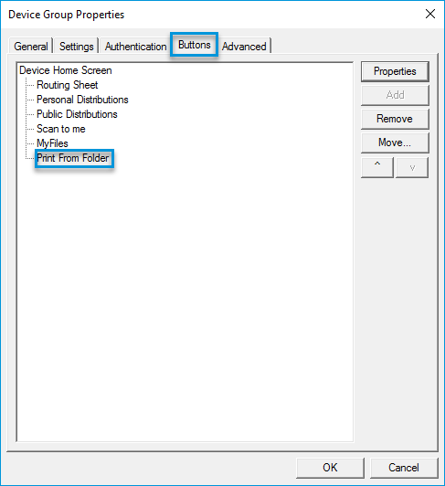

To apply the Print From Folder button to the device
- Select Devices on the Server Administrator tree and use the arrow to expand, if necessary. The devices appear in the Devices details pane.
- Select the appropriate device. The Device Group Properties dialog box appears.
- Select the Buttons tab. The Device Home Screen button list appears.
- Click Add. The Add Button dialog box appears.
- Select Print From Folder on the Type drop-down list.
- Use the default name or type a new name in the Name box.
- Click OK on the Add Button dialog box.
- Ensure the Print From Folder label appears on the Device Home Screen button list.
See the Device Group Properties example below.
- Select Print From Folder or use the Properties button. The Button Properties dialog box appears.
- Select the Options tab.
- Select Display the following folders and then choose all or specific folder check boxes.
Note: Printing from a folder is allowed if you selected to display a folder that does not have the Allow printing from folder property enabled. Ensure you have enabled the property and selected the appropriate folders you want to display at the device.
- Click OK on the Button Properties dialog box.
