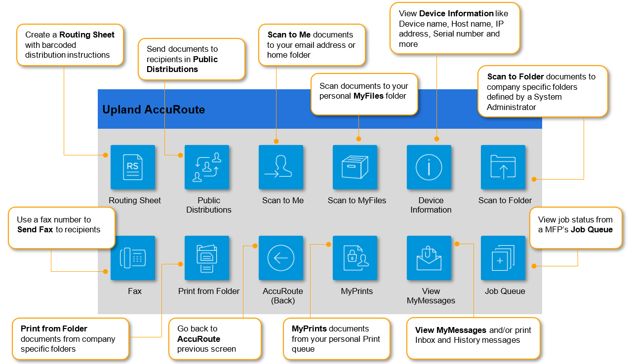

Device Buttons at a Glance
Note: This is an example. The buttons on your device may appear differently.
