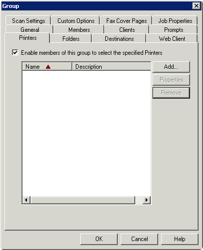

  2. Start Server Administrator, expand the tree view, and click Configuration > Groups.
  3. In the right pane, double-click on the Default group (or applicable group). The Group page is displayed.
  4. Click on the Printers tab.
  5. Select Enable members of this group to select the specified Printers.
  6. Click the Add button. The Add Printer page is displayed.

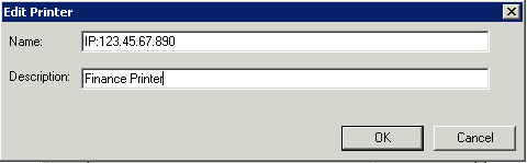

  7. Enter the printer information. For example:
  8. Click OK. Click OK again to save the changes. Refer also to Selecting a network printer.

  4. Highlight the printer that needs to be modified and click Properties.
  5. On the Edit Printer page make all needed changes and, when finished, click OK.
