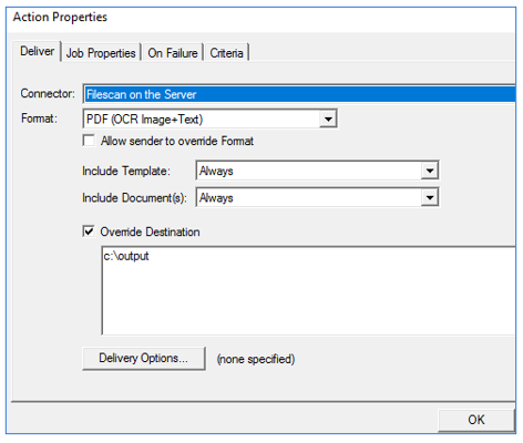

Select Fax number on the Destination type drop-down list.
Type 1111 in the Matches box.
Select Next. The Deliver wizard options appear.
Select Filescan on the Server on the Connector drop-down list.
Select PDF (OCR Image+Text) on the Format drop-down list.
Select the Override Destination check box.
Type C:\output in the Override Destination box.
Select Next. The wizard applies a default name to the rule. Use the default name or rename if necessary.
Select Finish. The rule appears in the User RuleSets folder.
See the completed File Conversion rule properties example below.

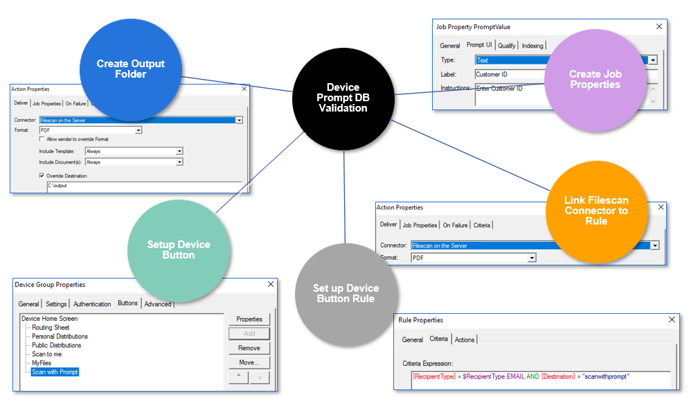

Device Prompt DB (Database) Validation Rule Example
In this example, the Administrator of a Sales firm has a requirement to prompt a device user to specify a Customer ID that will be validated and used to retrieve the Customer Name from the company’s database. The scanned document with the Customer ID and Name metadata is sent to an output folder where the ID and Name values are used to name the document. The document is then submitted to another destination, for example, SharePoint or other database.
Note: The Administrator has a database table set up that contains the customer information needed for the rule. SQL CALLs are made to validate and retrieve the customer information needed for document processing.
Resources used to create this rule include:
Output Folder
Job Properties
Device Button
Device Button Rule
Filescan Connector
The Administrator creates a folder locally and provides the Filescan connector service access and permissions to the following folders.
C:\output
Note: The folders can be created on a network. The Filescan connector service must have access and permissions to these types of folders as well.
The Administrator creates two job properties. One is used to prompt the device user to specify the Customer ID and is set up as the Prompt Value. The other job property is Customer Name which is retrieved from the database and is set up as a Related Value.
To create the Customer ID job property
In the Server Administrator, expand Configuration.
Right click User. The Properties shortcut menu appears.
Select New > Job Property. The Job Property dialog box appears.
Type PromptValue in the Name box.
Select the Prompt UI tab.
Type Customer ID in the Label box.
Type Enter Customer ID in the Instructions box.
Select OK on the Job Property dialog box. The PromptValue job property appears in the Details pane.
To create the Customer Name job property
Type RelatedValue in the Name box.
Type Customer Name in the Label box.
Select OK on the Job Property dialog box. The RelatedValue job property appears in the Details pane.
The Administrator sets up the validation parameters for PromptValue. The Customer ID must be a valid entry in the database before Customer Name is retrieved from it and displayed at the device.
To set up the PromptValue SQL validation
In the User Job Property details pane, select PromptValue. The Job Property dialog box appears.
Select the Qualify tab.
Select Database ADO from the Validation drop-down list.
Select Configure. The Validation Properties dialog box appears.
Ensure Mandatory: User must specify a valid value option is selected.
Note: The Mandatory option displays a Next button if the value entered by a device user is valid. If the value is invalid the Next button is not displayed. If Optional is selected, the Next button is displayed if the value entered by the device user is valid or invalid.
Select the ADO tab.
Type the DSN string for the DB connection in the DSN box.
Type the following SQL CALL statement to retrieve the Customer Name based on the device user’s entry in the Query box.
Select RelatedValue as [{RelatedValue}], PromptValue as [{PromptValue}] from PromptRelated where PromptValue = '%PromptValue%'
Note: In the SQL CALL statement above, the selected table fields are represented in red. The job properties that will be assigned a value are represented in blue. The property that contains the data entered by the device user is represented in gray.
The Administrator tests the PromptValue SQL validation to ensure that the job properties, validation, and communication to and from the database are successful.
To test the PromptValue SQL validation
In the Validation Properties dialog box, select Test. The Test Validation dialog box appears.
Type a valid Customer ID in the PromptValue box and select Test. The Validation Test dialog box appears with the appropriate Customer Name.
Close the Validation Test dialog box.
Select OK on the Validation Properties dialog box.
Select OK on the Job Property PromptValue dialog box.
