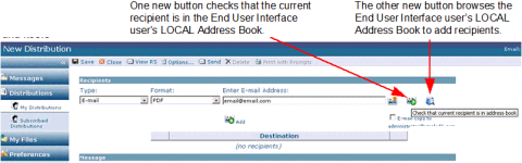

You can use the OCX for Address Book browsing. Enabling this feature requires two steps:
Selecting the Use Addressbook OCX option on the General tab of the Web Client View Properties page
Enabling ActiveX options on the desktop
After you complete these steps (described below), the Web Client will have two additional buttons:![]()
Step 1: Enabling the Use Addressbook OCX option
On the Web Client View Properties page (General tab), select the Use Addressbook OCX option in the Options section.
Click OK to save your changes.

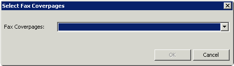

You can make fax cover page templates available for use by using the Web Client View Properties page.
To make Fax Cover Page templates available
On the Web Client View Properties page, click the Fax Coverpages tab.
To add a cover page, click the Add button. The Select Fax Coverpages dialog is displayed.
Select a cover page file. Click OK. The file is added to the list. For example:
If you want to change the default cover page selection, highlight the name and click the Set Default button. An asterisk (*) appears in the Default column to the left of the cover page name.
