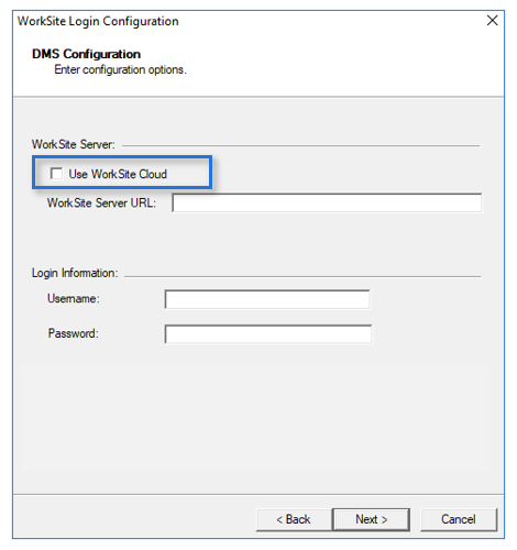

To configure the WorkSiteRESTV2 connector
Open AccuRoute Desktop.
Select Tools > Configure DMS > WorkSiteRESTV2. The WorkSite Login and DMS Configuration wizard appears.
See the WorkSite Login and DMS Configuration wizard example below.
Ensure the Use WorkSite Cloud check box is not selected.
Specify the appropriate URL in the WorkSite Server URL box. Contact your Administrator if you do not know the URL.
Specify your username and password in the Username and Password boxes. Contact your Administrator if you do not know your username and password.
Select Next. A message may appear if there are any login or configuration issues. Contact your Administrator to resolve the issue.
Keep the default configuration options as is.
Select Finish.

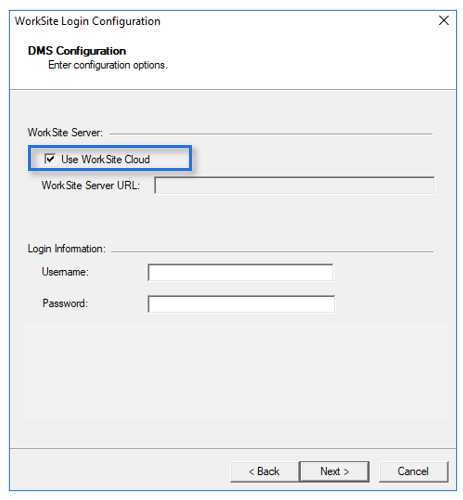

You must configure the WorkSiteRESTV2 connector by using Tools in AccuRoute Desktop.
Select the Use WorkSite Cloud check box.
Select Finish.

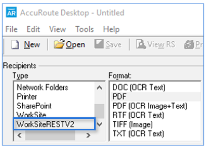

You will see the WorkSiteRESTV2 connector in the AccuRoute Desktop > Recipients > Type list. The connector can be used to profile documents to the WorkSite server and create Embedded Directives (distributions) and/or routing sheet destinations.
See the Recipients > Type List example below.
