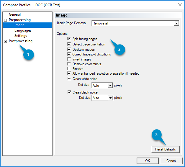

compose profiles dialog box
Compose Profile Dialog Box Legend
Description
1. Navigation and Selection pane
Use the Plus or Minus (+) (-) icons to expand or collapse the Pre and Postprocessing categories.
Use to navigate and select different categories.
2. Preprocessing and Postprocessing pane
View and select Pre and Postprocessing settings.
3. Reset Defaults button
Use the Reset Defaults button to reset specific default settings, if necessary.
