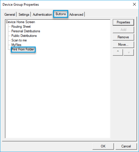

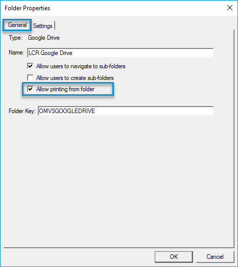

Administrators can provide device users the ability to print documents from virtual folders supported by the Upland AccuRoute server. The Allow printing from folder property is applied to specific folders that device users can access and print from.  A Print from Folder button appears on the device home screen that allows device users to select and print documents. In addition, device users can choose a series of options to easily navigate, find, and select documents for printing.
Understanding how Allow printing from folder works
The Allow printing from folder property can be flexible or strictly enforced at the Group level. You can override the property at the button level so that device users can view, access, and print from all folders if necessary. See examples below.

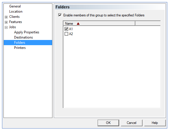

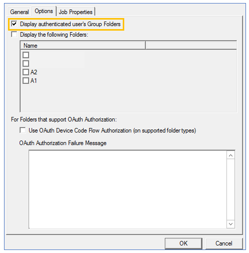

Example: Allow printing from folder at the Group level
The Administrator at company A creates 2 folders. The A1 folder is set to allow printing from the folder. The A2 folder is not. By using Configuration > Groups, the Administrator enables members of a group to only select the A1 folder. In this example, the Print from folder button is configured by only selecting the Display authenticated user's group folders option. The Display the following folders option is not selected. The A1 folder is the only folder that is displayed at the device and allows printing.
Group > Folders Properties Device Group > Button Properties
group folders properties dialog box example A folders device group button properties dialog box example A folders

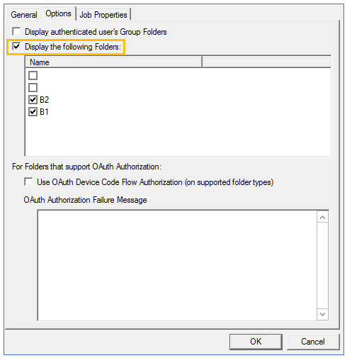

Example: Allow printing from folder at the Button level
The Administrator at company B creates 2 folders. The B1 folder is set to allow printing from the folder. The B2 folder is not. By using Configuration > Groups, the Administrator enables members of a group to only select the B1 folder. In this example, the Print from folder button is configured by selecting the Display the following folders option. Both B1 and B2 folders are selected and will be displayed at the device and allow printing. The button level options override the Group level options in this scenario.
group folders properties dialog box example B folders device group button properties B folders
