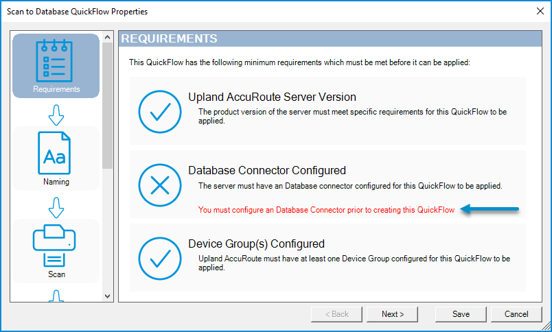

Before you begin
A minimum requirements check is done when you create a new QuickFlow. A message appears if the minimum requirements are not met. You will not be able to continue and configure the QuickFlow until the minimum requirements pass this check.
Tip: Ensure you have the appropriate connectors and devices configured before you begin.
See the Minimum Requirements Check below.
quickflows minimum requirements check dialog box example

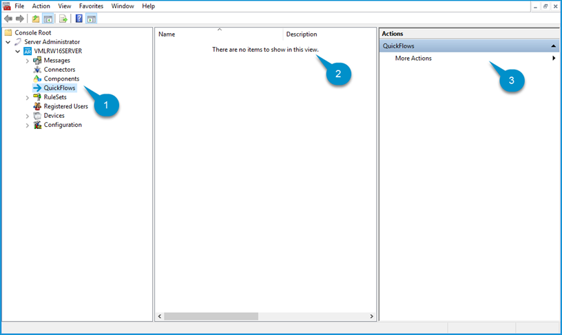

QuickFlows at a Glance
quickflows at a glance
QuickFlows Window Legend
Description
1. MMC Scope (Server Administrator) pane
Use the MMC Scope (Server Administrator) pane to:
  • View and access all Server Administrator functions including QuickFlows.
  • Create new QuickFlows with the New menu.
Note: MMC is an acronym for Microsoft Management Console.
See About Server Administrator for more information.
2. MMC Result (QuickFlows) pane
View and access saved QuickFlows.
Note: The QuickFlows pane is blank when there are no saved QuickFlows.
The following message appears: There are no items to show in this view.
3. Actions pane
Create new QuickFlows with the More Actions > New menu.
Tip: Any of the panes can be expanded to view more information if the QuickFlows window is resized. See how below.
