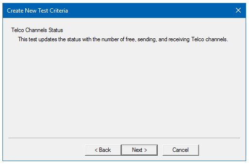

  3. Select New > Telco Channel Status. The Create New Test Criteria wizard appears.
See the Create New Test Criteria wizard example below.
create new test criteria wizard example

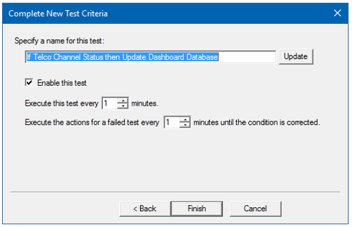

  7. Select Next. The Complete New Test Criteria wizard appears.
See the Complete New Test Criteria wizard example below.
complete new test criteria wizard example
  1. Use the default test name or specify a new name in the box and select Update.
Note: Specifying a new test name is optional.
  1. Ensure the Enable this test check box is selected.
  2. For optimal results, set Execute this test every (value) minute(s) to 1 minute.
  3. For optimal results, set Execute the actions for a failed test every (value)…. to 1 minute.
  4. Select Finish. The Telco Channel Status test appears in the Description details pane.
