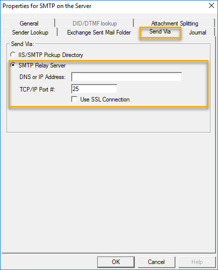

  • SMTP server (required if the SMTP connector is configured to use SMTP Relay Server)
  • Internet Information Services (IIS) (required if the SMTP connector is configured to use IIS/SMTP Pickup Directory)
  • Virtual SMTP server properties configured with the address of the SMTP server. For instructions, see Configuring virtual SMTP server properties. (required if the SMTP connector is configured to use IIS/SMTP Pickup Directory)
Note: A IIS requirement change has been made for Administrators who are moving away from the traditional IIS/SMTP configuration. Administrators can specify the use of a SMTP Relay Server as a result of Microsoft limiting the use of IIS. See Setting the SMTP Relay Server for more information.
