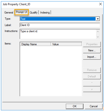

Client_ID as a text prompt
Client_Name as a text prompt
US_Matter_ID as a SQL List prompt
International_ID as a SQL List prompt
User instructions are provided for each prompt.
See the Job Property Client_ID dialog box example below.

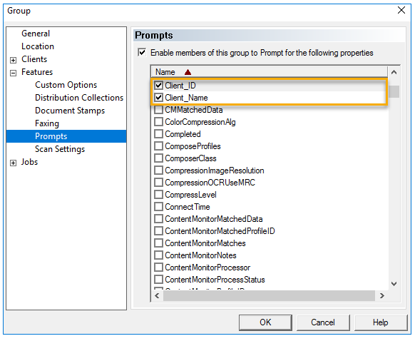

In addition, the prompts are enabled for various groups to use.
See the Group > Features > Prompts dialog box example below.

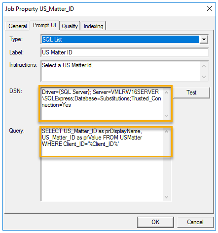

Administrators specify the following DSN and Query parameters for the US_Matter_ID SQL list prompt.
Note: The DSN and Query parameters must reflect your actual DSN and Query values.
See the DSN syntax example below.
Example: Driver={SQL Server}; Server=; Database=
Parameters are separated by using the semicolon ( ; ). Your values must be entered after the equal (=) symbol.
See the Query syntax example below.
Example: SELECT US_Matter_ID as prDisplayName, US_Matter_ID as prValue FROM USMatter WHERE Client_ID='%Client_ID%'
US_Matter_ID as prDisplayName is the column name that will be displayed.
US_Matter_ID as prValue is the column value that will be passed through.
Note: In this example, no default column was specified.
FROM USMatter is the database table that will be queried.
WHERE Client_ID=’%Client_ID%’ represents the substitution that will take place. The Client_ID text column value is substituted with the Client_ID column value from the database table.
Note: Substitutions are specified with a percent symbol in the beginning and at the end, for example, %Client_ID%. Single quotes ( ' ) that enclose the %Client_ID% substitution are part of the WHERE clause.
See the Job Property US_Matter_ID dialog box example below.

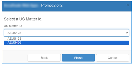

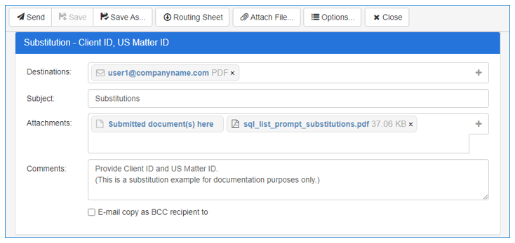

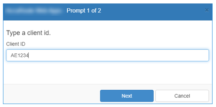

Client ID and US Matter ID
See the
| Client ID prompt | US Matter ID prompt |

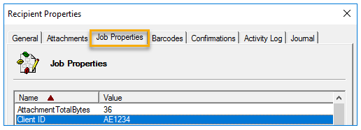

The Administrator verifies the Client ID and US Matter ID are passed through correctly by using the Messages > In History folder in the Server Administrator.
See the Messages > In History folder > Recipient Properties > Job Properties dialog box example below.

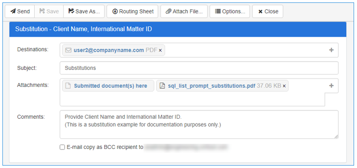

Client Name and International Matter ID

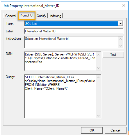

Another group of
See the Job Property International_Matter_ID dialog box example below.
Note: This job property is similar to the US_Matter_ID job property. However, the database table and substitutions are different. In this example, the values used in the Query statement are related to Client_Name and International_Matter_ID.

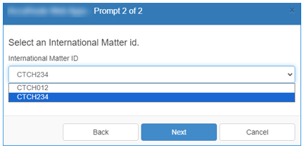

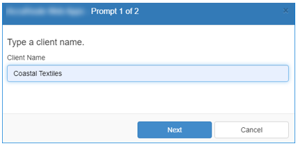

See how the prompts work in the
| Client Name prompt | International Matter ID prompt |
