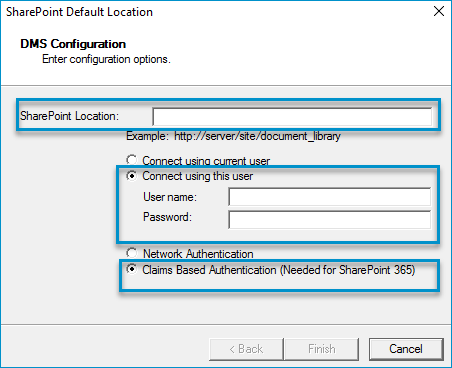

  5. Specify the following Configuration options.
    • Type the SharePoint address in the SharePoint Location box. The address must begin with https://. See example below.
      • https://yoursite.sharepoint.com
    • Select the Connect using this user option and specify the username and password of the user with full access to the SharePoint site. The username must be in an email address format.
    • Select the Claims Based Authentication (Needed for SharePoint 365) option.
  1. Click Finish.
See the DMS Configuration  wizard page example  below.
