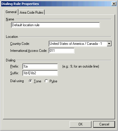

Dialing rule with access and billing codes example
The following example shows a dialing rule properties after it has been created/modified to include the access code in the dialing prefix and two billing codes in the dialing suffix.
dialing rule with access and billing codes dialog box example
