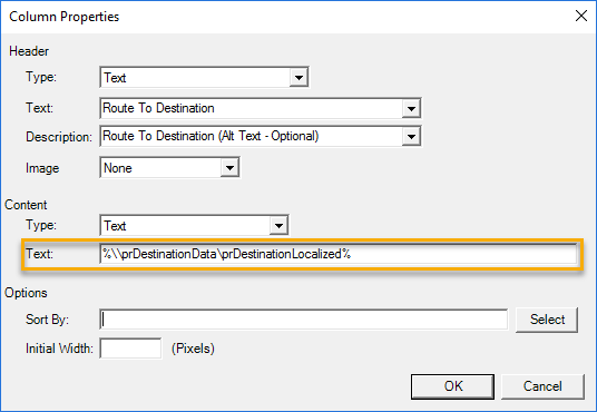

  6. Select Add. The Column Properties dialog box appears.
See the Column Properties dialog box example below.
column properties dialog box example
  1. In the Header area, select a Header type from the Type drop-down list, for example, Text.
  2. Type a column header, for example, Route to Destination in the Text box.
Note: You can select a pre-defined property from the Text drop-down list to use as a column header. In this scenario, you must specify a Column header name, for example, Route To Destination.
  1. Type a description in the Description box. (optional) The description is displayed as Alt Text when users move the mouse over the column header.
  2. Select an image type from the Image drop-down list. (optional)
  3. In the Content area, select a cell format from the Type drop-down list, for example, Text.
  4. Type the following property value in the Text box.
    %\\prDestinationData\prDestinationLocalized%
  5. Select OK on the Column Properties dialog box.
