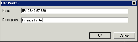

  4. Highlight the printer that needs to be modified and click Properties.
  5. On the Edit Printer page make all needed changes and, when finished, click OK.
