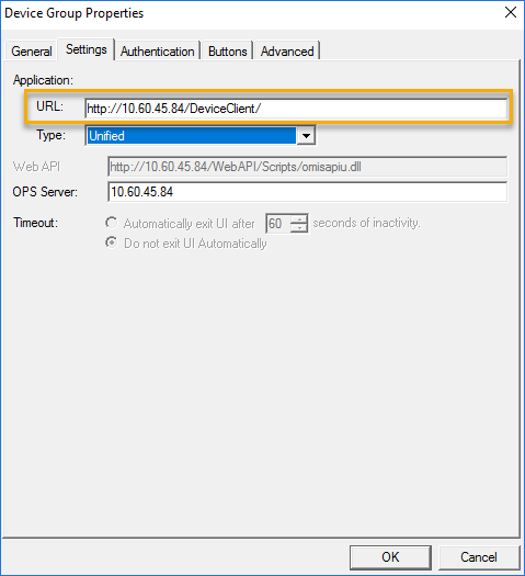

  3. Right-click the appropriate device group and select Properties. The Device Group Properties dialog box appears.
See the Device Group Properties dialog box below.
device group properties dialog box example application url
  1. Click the Settings tab.
  2. Ensure you enter the fully qualified domain name and port number in the following format. See example below.
  3. Example: https://fully_qualified_domain_name:port_number/DeviceClient/
  4. Click OK.

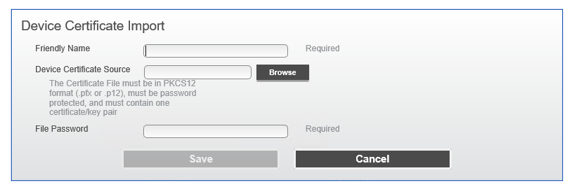

  5. Select Importon the Device Certificates section. The Device Certificate Import dialog box appears.
See the Device Certificate Import dialog box example below.
device certificate import dialog box example
  1. Type the certificate's friendly name previously created when completing the certificate request in the Friendly Name box.
  2. Type or select Browse to find the PFX Certificate file.
  3. Type the file password previously created when creating the Self-Signed CA certificate in the File Password box.
  4. Click Save.
