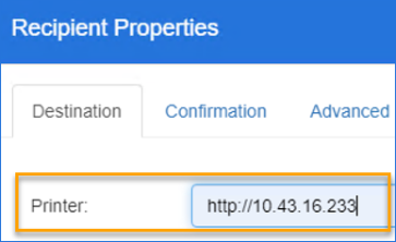

Using WebApps
Use the Create Distribution option to create a distribution for IPP/IPPS enabled printers.
The printer is identified with a URL IP address only, for example, http://10.43.16.233. Server names are not used.
The server will look for IPP/IPPS printers on port 443 by default unless specified otherwise with a colon, for example, http://10.43.16.233:9100. A colon and port number is used after the IP address.
Contact your Administrator for information about your IPP/IPPS printers, if necessary.
See the WebApps > Printer Destination example below.
recipient properties printer destination example
Note: The URL IP address can also use https://.
See About Distributions for more information.

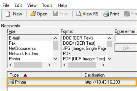

Using AccuRoute Desktop
Use AccuRoute Desktop to create Embedded Directives that include printer-related recipient and destination types.
The server will look for IPP/IPPS printers on port 80 by default unless specified otherwise with a colon, for example, http://10.43.16.233:63. A colon and port number is used after the IP address.
See the AccuRoute Desktop > Printer Embedded Directive example below.
accuroute desktop printer embedded directive dialog box example
See the AccuRoute Desktop Client User Guide for more information.
