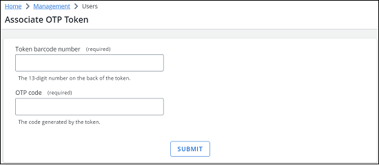

Once you have logged in, you will notice a banner at the top of the screen prompting you to associate the token with your user.
Clicking the 'Associate OTP Token' button will open a form to associate your token. Associating a token requires only two steps; entering the serial number and an OTP code.
The serial number is the 13-digit number on the back of the token. You will then need to press the token to generate a one-time passcode, and enter this in the required field. Clicking 'Submit' will return you to your workspace, with a notification at the top of the screen displaying 'This token is now associated with your account'.
