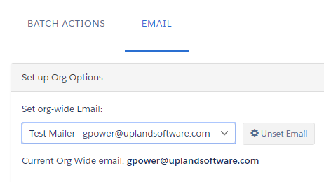

  1. Open the Max Administration tab.
  2. The Admin page opens. Click EMAIL.
  3. In the Set Org-Wide Email field, select the org-wide email address you want to use. The drop-down has all the org-wide email addresses set up in the org.
  4. Click Set Email.

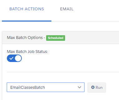

  1. In the Max Administration page, click BATCH ACTIONS.
  2. Select EmailClassesBatch.
  3. Click Run.

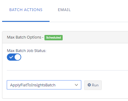

  2. Set the Max Batch Job Status switch to ON.
  3. Select ApplyFlatToInsightsBatch.
  4. Click Run.
Email digests are now scheduled for enabled users. The default frequency is hourly.

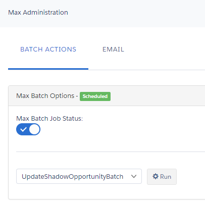

  1. Open the Max Administration page in Salesforce.
  2. Click BATCH ACTIONS.
  3. Select the UpdateShadowOpportunityBatch drop-down option.
  4. Click Run.
When the batch job is complete, you should see '1/1' and 'Completed':

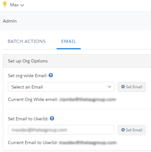

Setting Email Digests to Go Only to You
When you are testing the email mechanism, you will probably want to ensure that other users don't receive your test emails.
You can override normal email behavior so that email digests go only to you.
The Set Email to UserId field in the EMAIL tab contains the user name (an email address) you used to log into your org. Click Set Email beside this field to set all email digest messages to go only to that address.

  1. Click BATCH ACTIONS on the Max Administration tab.
  3. Click Run.
