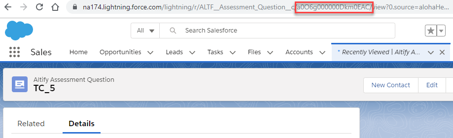

Get the Record ID of the Compelling Event Question
Begin by obtaining the record ID of the 'Compelling Event' assessment question.
- Open the Altify Assessment Questions tab in Salesforce. (If this tab doesn't already exist, you'll need to set it up first.)
- Open Compelling Event.
- In your browser's address field, copy the ID of this assessment question and store it in a convenient location.
(This ID is unique to your org. The ID shown here is just an example.)

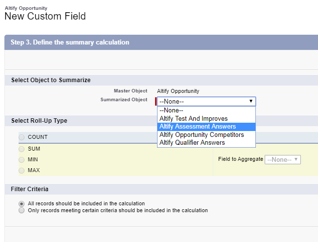

To create the Rollup fields:
- In Setup, open the Altify Opportunity object.
- In the Fields & Relationships section, click New.
- Select Roll-Up Summary, and click Next.

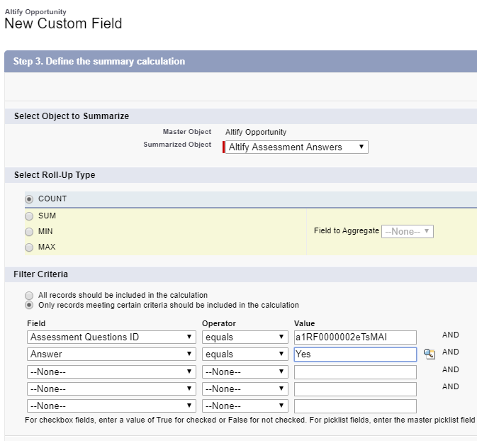

- This field will check whether the Compelling Event question's answer is Yes. Give the field a suitable label, such as Assessment Yes.
- Give the field a suitable API name.
- Click Next.
- In the Summarized Object drop-down, select Altify Assessment Answers.
- Select the COUNT radio button.
- Select Only records meeting certain criteria....
- You need to specify two criteria:
- Assessment Questions ID equals ['Compelling Event' record id]
- Answer equals Yes
- Click Next, and Next again.
- Click Save & New.

The record ID is the one you stored earlier.
'Assessment No' field:
'Assessment Unknown' field

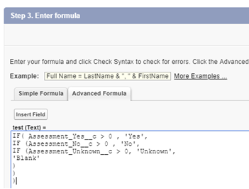

- Enter the following formula :
- Click Save.
IF(Assessment_Yes__c > 0 , 'Yes', IF (Assessment_No__c > 0 , 'No', IF (Assessment_Unknown__c > 0, 'Unknown', 'Blank' ) ) )

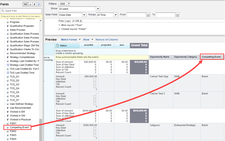

Add the Signal Field to Reports
Now that the signal field is created, add it to the report type and report that underlie every view in which you want the signal to be shown.
For any view that should not display the custom signal, omit the field from the underlying report.

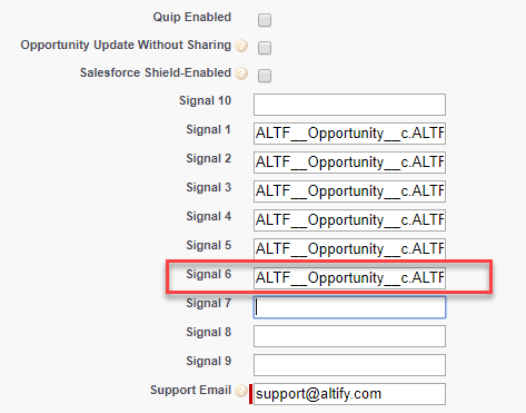

To associate the signal field with a Plan Status icon, you specify the signal field's API name in Custom Settings.
- In Setup, go to Custom Settings.
- Click Manage beside Altify Core Settings.
- Click Edit.
- In the next available Signal field, specify the signal field's API name.
- Click Save.
In this example, the API name is ALTF__Opportunity__c.ALTF__Compelling_Event_Signal__c
, and it is associated with the sixth signal icon.

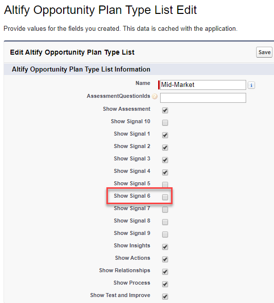

Hide the Signal on Irrelevant Plan Types
If it is the case that the custom signal is irrelevant to a particular opportunity plan type (because the signal is based on data excluded from opportunities of that type), you will probably not want the signal icon to be shown for opportunities of that type.
In this example, the custom signal is irrelevant to Mid-Market opportunities because the Compelling Event assessment question is not available on those opportunities.
To hide the signal icon on those opportunities:
- Click Manage beside Opportunity Plan Type List.
- Click Edit.
- Deselect the Show_Signal6 checkbox.
- Click Save.

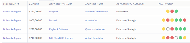

The extra Plan Status icon is now shown in all TeamView views.
It is hidden for Mid-Market opportunities, but is shown for the other opportunities in this example:
