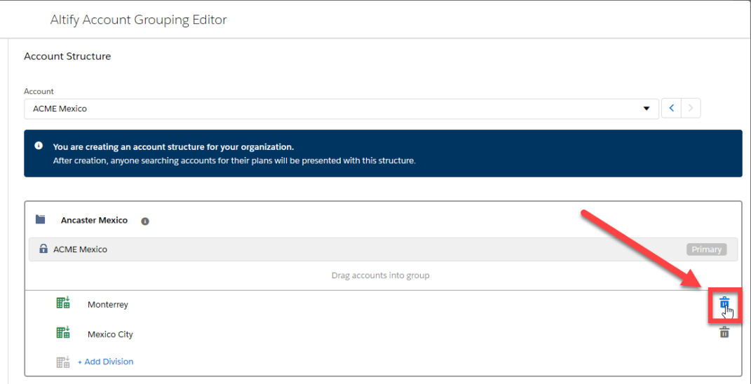

To delete an account division, do the following:
  1. On the Account Structure tab in Plan Settings, click the Edit Structure button on the row for the relevant account.
  2. Click the trashcan icon for the division that you want to remove - as indicated in the example below.
