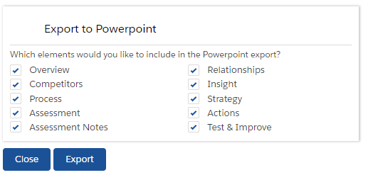

  3. The Export Powerpoint dialog opens. Here you can select which elements of the opportunity you want to include in the Powerpoint file. (The set of options you get depends on the configuration of your org.)
  4. When you have made your selections, click Export.When the Powerpoint export file is ready, click the link Click to save.

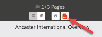

Note: To generate a PPT of only insights, you need to access the insight map in slideshow mode. In this mode, click the PPT icon (as shown below) to generate a PPT file for the section of the map that is currently displayed.
