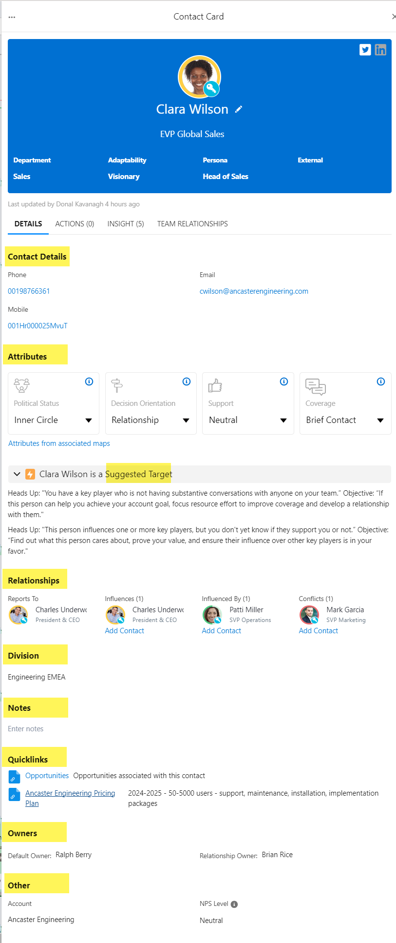

Hiding or Reordering Sections on the Contact Information Panel
The sections on the Details tab of a contact's information panel (highlighted in the example below from an account relationship map) can be hidden or reordered if required.
To hide sections or reorder them, do the following:

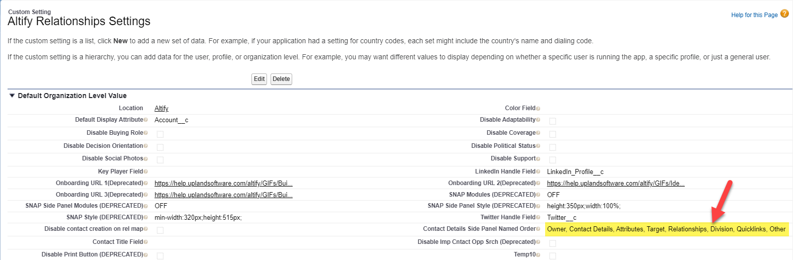

  1. In Setup, go to Custom Settings.
  2. Click Manage beside Altify Relationships Settings.
  3. Click Edit on the Altify Relationships Settings page.
  4. In the setting Contact Details Side Panel Named Order, you need to enter the sections as a comma-separated list in your required order - leaving out any sections that you do not want to be displayed.
    The following are the section names that you need to use when composing your ordered list of sections:

    Note: This is the default order in which the sections are displayed (Contact Details, Attributes, Target, Relationships, Division A division is typically a smaller service unit or business unit within an account. By providing the same features as an account (row on the opportunity map, relationship map, insight map, etc.), divisions allow you to accurately map your customers' buying structures, without restriction to Salesforce Account records., Notes, Quicklinks, Owner, Other). If the custom setting is blank, this is how the sections are displayed.
  5. Click Save.

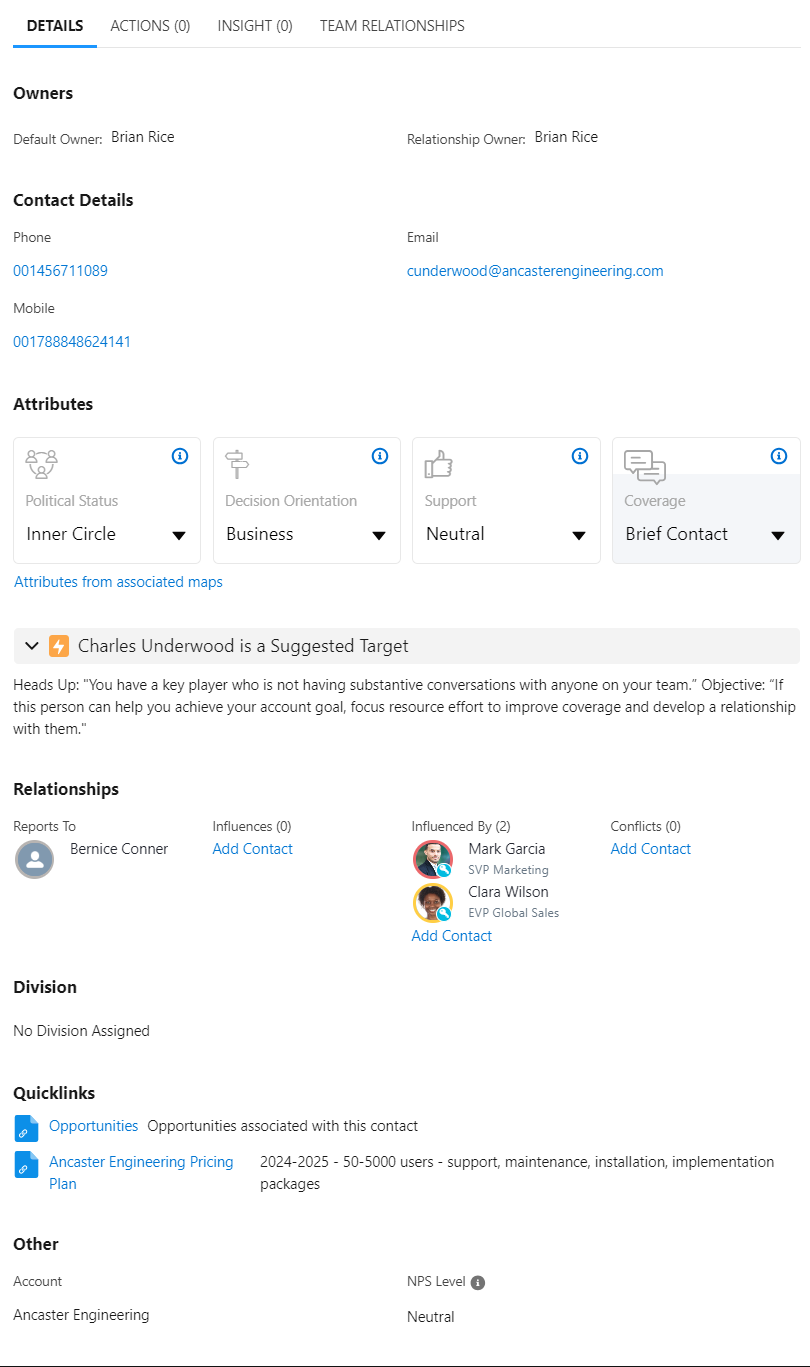

In the example below, the sections have been entered as follows in the custom setting: Owner, Contact Details, Attributes, Target, Relationships, Division A division is typically a smaller service unit or business unit within an account. By providing the same features as an account (row on the opportunity map, relationship map, insight map, etc.), divisions allow you to accurately map your customers' buying structures, without restriction to Salesforce Account records., Quicklinks, Other.
On an account relationship map, we can see that (as per the values entered above) the Owners section is displayed at the top of the panel, and the Notes section is no longer displayed:
