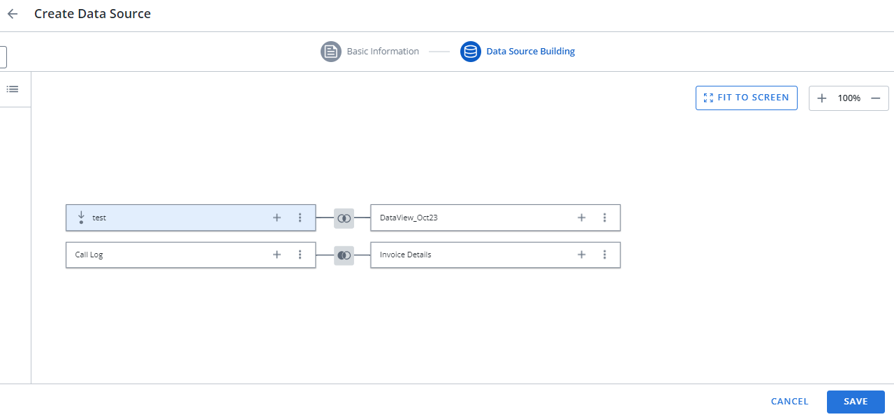

  13. Click Create. The Building Area is populated with the view(s) you selected:
  14. Screen capture showing an example view of the building area.
