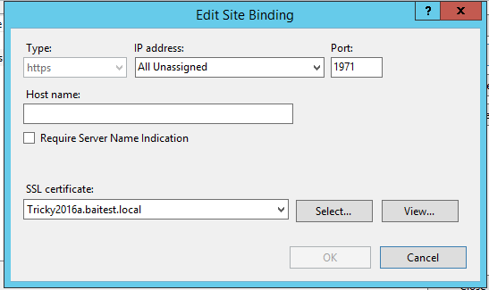

  1. Navigate to your IIS instance.
  2. Edit the current binding or add a new binding configured for HTTPS:

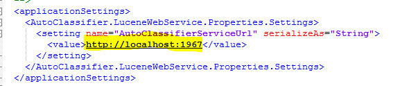

Lucene Component
Lucene is included by default with the AutoClassifier Engine.
  • If the Lucene component is not installed separately, skip this step.
  • In scaled environments, the Lucene component can be installed separately.
Procedure:
  1. Open IIS on the server hosting AutoClassifier.
  2. Locate the Lucene Component site.
  3. Locate and open the web.config file for editing.
  4. Update the AutoClassifierServiceUrl address to the new HTTPS address

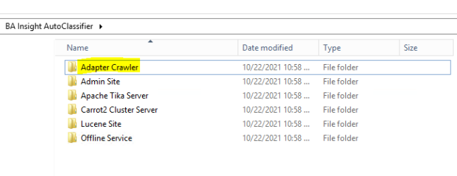

Adapter Crawler Component
  • If the Crawl Adapter service is not installed, skip this step
  • The Adapter Crawler is installed as a Windows Service and is installed in the same base location as the AutoClassifier Engine Site
Procedure:
On the server that houses AutoClassifier:
  1. Navigate to the AutoClassifier Engine installation location.
  2. The Engine is located under the "Admin Site" directory.
  3. Open the "Adapter Crawler" directory.
  4. Open the configuration file "AutoClassifier.AdapterCrawler.exe.config" for editing.
  5. Update the hostUrl value to the new HTTPS address:

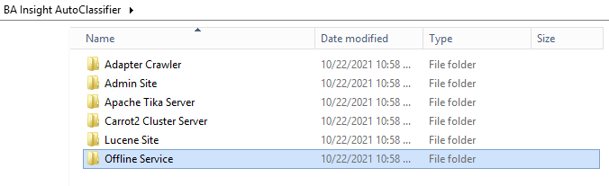

Offline Processing Service
If the Offline Processing service has not been installed this step can be skipped.
The Offline Processing service is installed as a Windows service and is installed in the same location as the AutoClassifier Engine Site.
Procedure:
  3. Open the "Offline Service" directory.
  4. Open the configuration file "BAInsight.AutoClassifier.OfflineService.exe.config" for editing:
  5. Update the hostUrl address to the new HTTPS address:
