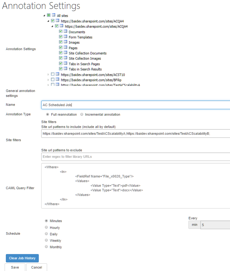

  3. Add Entry: Click and the Annotation Settings page appears:
  4. Name: Enter the name of your scheduled job.
  5. Annotation Type:
    1. Full reannotation: This operation re-annotates all of the documents regardless of whether they were annotated at upload time. For more information, go to Specify Document Tagging.
    2. Incremental annotation: Auto tag only the changed documents in the site collection/document library.
    3. Site filters > Site url patterns to include (include all by default): Specify the URLs to include using REGEX patterns. By default, all URLs are included if you do not specify any URLs here.
  6. Site filters > Site / library url patterns to include / exclude: Specify the URLs to exclude using REGEX patterns. Specify multiple REGEX expressions separated by semicolon ' ; ' .
  7. CAML Query Filter: Specify a CAML Query WHERE Clause to filter specific items in your SharePoint lists or Document Libraries.
    Example of a CAML Query filter that processes only PDF and DOCX files:
    Copy
    <Where>
        <In>
           <FieldRef Name="File_x0020_Type"/>
              <Values>
                  <Value Type="Text">pdf</Value>
                  <Value Type="Text">docx</Value>
              </Values>
        </In>
    </Where>
  8. Schedule: Click a check box to specify the annotation schedule. (By default, Minutes is selected.)
  9. Clear Job History: For every 100 items annotated, the job progress is stored so that in case of failure the job can pick up where the job left off on the last run.
    1. Select this option if you want annotation to start fresh in the event of a failure, with no saved starting point.
  10. Click Save to see your job in the Annotation Schedule page.

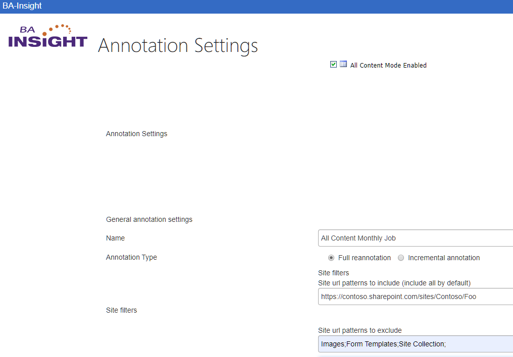

All Content Mode
"All Content Mode" always includes all the site collections and sites where the AutoClassifier App was deployed/configured (manually from Site Contents or using the SideLoader tool) in your scheduled annotation jobs.
So, after you define a Job Schedule and Filters, all the sites and site content the AutoClassifier App is deployed to (now and in the future), will be included in Scheduled Annotation Jobs.

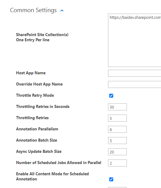

  1. To enable the "All Content Mode" for Scheduled Annotation, check the "Enable All Content Mode for Scheduled Annotation" under the "Common Settings" section of the Add-In Configuration page.
  2. When All Content Mode is enabled, the site's hierarchy is no longer displayed in the scheduled jobs page "Annotation Settings":

The number of jobs that can run by default in parallel is 2.
Changing this is possible via the ScheduledJobsAllowedInParallel option from the AutoClassifier for SharePoint Add-In web.config file:
   <add key="ScheduledJobsAllowedInParallel" value="2" />
It is not recommended this value be increased without justification as each job does parallel processing itself.
Changing the setting could throttle the system and degrade performance

Job1: Site url patterns to include: https://contoso.sharepoint.com/sites/Contoso/A;https://contoso.sharepoint.com/sites/Contoso/B;https://contoso.sharepoint.com/sites/Contoso/C;
Job2: Site url patterns to include: https://contoso.sharepoint.com/sites/Contoso/D;https://contoso.sharepoint.com/sites/Contoso/E;https://contoso.sharepoint.com/sites/Contoso/F;
How to Use Site Exclusion Filters to Improve Performance
In general there are lists or libraries that you don't want to process in the scheduled annotation, for example the out of the box lists and libraries that are created when a new site is created: ("Form Templates", "Style Library", "Images", etc.).
To completely skip these libraries across all sites and improve overall scheduled job performance, site exclusion filters should be used, as shown in the example below:
Site url patterns to exclude: Form Templates;Style Library;Images
