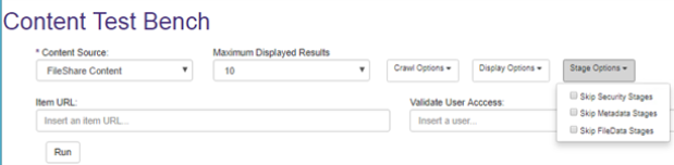

If from the Test Bench you select Skip FileData stages, the Tika stage will be skipped.
