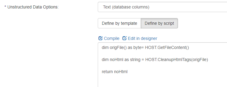

How to Remove the HTML Tags from Item Body
Usage: Unstructured data column
Description: Use function HOST.CleanupHtmlTags to update the content by removing the HTML tags.
dim origFile() as byte= HOST.GetFileContent()
dim noHtml as string = HOST.CleanupHtmlTags(origFile)
return noHtml
